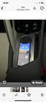

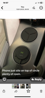

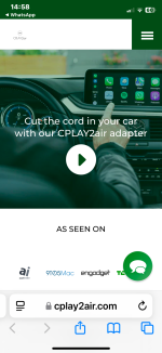

Hi no need to use the 12 volt socket in boot and run a cable I just use the usb c socket under the arm rest and it plugs into a round style wireless charger pad that I placed on top of the first cup holder which I am happy not to use. Other cup holder still good access even with iPhone 11 Pro laid out on top of wireless pad. I also use a CarPlay dongle in the regular usb socket beside the usb c one under the arm test and all works in tandem. Regards Ronan
Pics

Great idea/setup - the only reason for using the 12V socket in the trunk is the amount of power. The USB C socket under the armrest is only 1.5A/5W (if I remember correctly) and the one in the trunk is 120W allowing for much faster charging - e.g. using the Apple Magsafe wireless adapter that charges with 25W (if supplied with at least 30W input).
According to the user manual, the rear power socket is connected to the fuse box in the front compartment (F44) and has a 25A fuse (edited: so more like 300W (12V*25A=300W)). So I would be tempted to lead a cable to the fuse box instead of the trunk.
There is also a fuse box in passenger compartment, with some unused slots. I wonder if we could add a 25A fuse there instead. That fuse box is located "behind the driver side knee trim panel", but not sure if the manual is for LHD or RHD.
