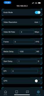

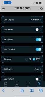

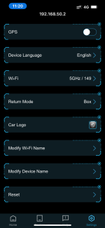

OK, so after a few different attempts, and two different wireless adapters, I think I’ve got wireless CarPlay working as well as it can in my Trophy.
The adapter I’m using is a CarLinkit 4.0, model CPC200-CP2A
Connected to car using instructions provided - connect Bluetooth, connect to Wi-Fi, check update etc.
Once all up and running, I’ve set the values on the adapter Home Screen (192.168.50.2) as shown in the attached files.
Now, I’ve found that leaving it set up like this, the connection is random, and slow - I think there are Wi-Fi conflicts which cause problems.
So I tried forgetting the adapter Wi-Fi network on my phone, forcing the adapter to connect to car via Bluetooth.
This (so far - 3 days and counting) seems to be reliable, and pretty quick to connect. All CarPlay functions work well, and screen is responsive, CarPlay info is also shown on small drivers screen - of course, things may be different in your car ….. but this might work for you.
My setup is late ‘23 reg Trophy (the updated model with rear wiper and 18” wheels) running R40 entertainment, using Genuine CarLinkit 4.0, iPhone 13 on iOS 17.4.1
Hope this helps

It was turning on the ‘background’ tab that fixed mine. You might try toggling this and/or the ‘sync mode’
Thanks but I’ve already tried toggling those two in all combinations. I’ve probably spent several hours trying all sorts of different setting combinations before posting on here.
I was hoping someone had the exact issue I am describing and had a definite fix. Beginning to think it is just a quirk of my car/carlink unit!

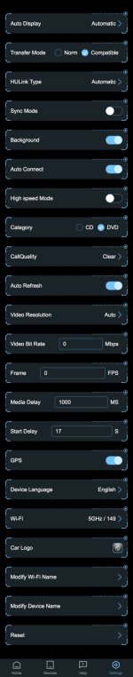

Using these as a guide (plus changing the start delay to 20 sec) I’ve had success too with a CarLinkit 5.0 2air…
…with one exception: When CarPlay is playing music, with the infotainment unit at the Home Screen it always says “Unknown/Unknown” for the track and artist, and often a Play button even though already playing.
Anyone else seeing that? The dodgy documentation makes me think the CarLinkit “Sync” setting is relevant, but makes no difference with it on or off.
Edit: Since posting this, I toggled Sync on & off again and now it is showing the title/artist albeit still with no artwork. Wonder if that setting will stick though...
Ah, much better ? A couple of pointers (at least ones I can replicate with my particular iPhone/CarPlay setup):
  • “Sync” stops the MG Home Screen play/pause button functioning
  • “High Speed Mode” causes frequent blank screen CarPlay problem
  • “Transfer Mode” seems to be specific to Android .. but I’m not game to change it while everything’s working ok
It also appears to prefer CarPlay being left in Dashboard mode (i.e. the screen that shows Map, Music and Siri Suggestions side by side) for the MG Home Screen to display the media info correctly.
