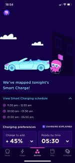

Hi
I have recently swapped from OG to IOG
I have an early MG 5 so no app. I Use a Myenergi Zappi 2.1 charger which provides my communication.
I believe that something went pear shaped when the app was loaded, there appears to be no way of telling the system what % charge I want or when I want the car to be ready or a bump charge capability.
The system did charge but to 100% which is not ideal
My app does not appear to do anything, no devices appear to be registered and settings only appear to cover basic account details
Does anyone have a similar car/charger set up to mine but with a more complete app?
Any help appreciated
unless I am misunderstanding you don't use the Zappi App, instead just try using the IOG App. As long as you have been accepted by Octupus then the schedule should show soon after you have plugged the car into Zappi, that is if you say what % charge you want and by what time.
