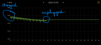

Thanks so much for sharing this idea @Lovemyev. Following another recent 12V battery failure I installed a 12V battery monitor. Data from the couple of weeks since then has shown a consistent drain on the 12V battery occurs between when the car (Mark 2) is fully charged and when it is unplugged from our EO 7kW AC charger. Sample picture attached. I would say that this is peculiar to this vehicle and this charger, as it has not occurred previously with other EVs and other charging methods (e.g. granny charger). What a pain.
