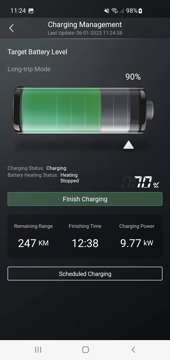

Since the last updates of the MG I smart app it shows in the charging screen Battery heating status. Is there a trigger in de app to turn this on when the car is connected to the wallbox prior to departing on a journey?

Today at the office on a wallbox I noticed the battery heater is on. It is chill outside.View attachment 14773
The heater's come on by itself because you're charging to 100% and activates at 80%. Only reason I know this is that I checked the app on my last charge and at 79%, no heater and then 80%, heating.

I wonder if this has to do with the weather. I will check during better weather conditions if it still does it when you charge past 80 percent.

Indeed and that on a 11kw wallbox. I will check Pebble his statement.
