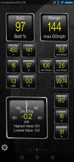

My SoH is still 100% after 18 months.
What app is that? Mine is different. I wonder if it only reports full percentages, so you're really 99. something. It's pretty hard to believe you'd still be at exactly 100% after a year and a half.
It's Torque Pro and I'll check re the decimal Place.
