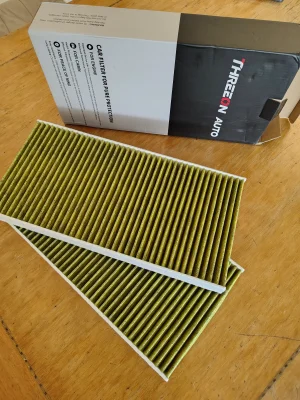

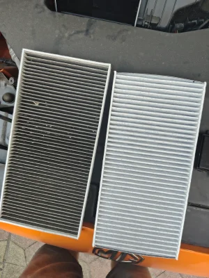

When I had my MG4 serviced. after the service, the car stank like a perfume factory. I found out that the replacement cabin air filter was sprayed with aftershave/perfume of some type. One thing I noticed is that there were two slots for air filters (one above the other), but I was only given one filter. After some research I found a replacement cabin air filter on Aliexpress, this was for two filters one dust filter and the other was a carbon filter.
It has made an huge difference to the air quality in the car. If anyone id interested here is the link for them.
I have been looking for a carbon filter, odd that it uses 2 different filters, normal to have 2 filters but they're normally the same
Does it say which goes where?
