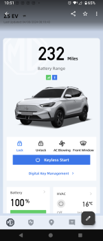

So far my SR shows roughly double the range for the charge - so 50% charge displays as about 100 miles range
If you reset both trips back to zero, before starting to charge, then go into the charging screen.
Set the slide bar to 80% level and then it should display a PREDICTED range when the charge is complete.
This figure can and will fluctuate depending on ambient temperature.
It will be higher in the summer and lower in the winter.
Because you have removed all of the historical efficiency data stored in the car, it then it loosely predicts the range generally based on traction battery SOH.
When the car was new, then when setting the charging level to 80% ( in warmer weather conditions ) you should return a predicted range of about 210 - 212 miles.
