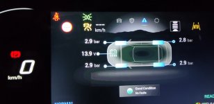

There is no "voltmeter" like on the original ZS EV that i could find.
There is an indicated voltage in one of the 4 menu's in the instrument cluster screen though, but it is not like on the old one, where it is an indicator of how charged the battery is, but more a "This is the current voltage" (Well, maybe the 4 bars under the battery is actually an indicator, but this menu is not the default when starting the car, so you have to flip through menu's to get to this screen)
See picture.
