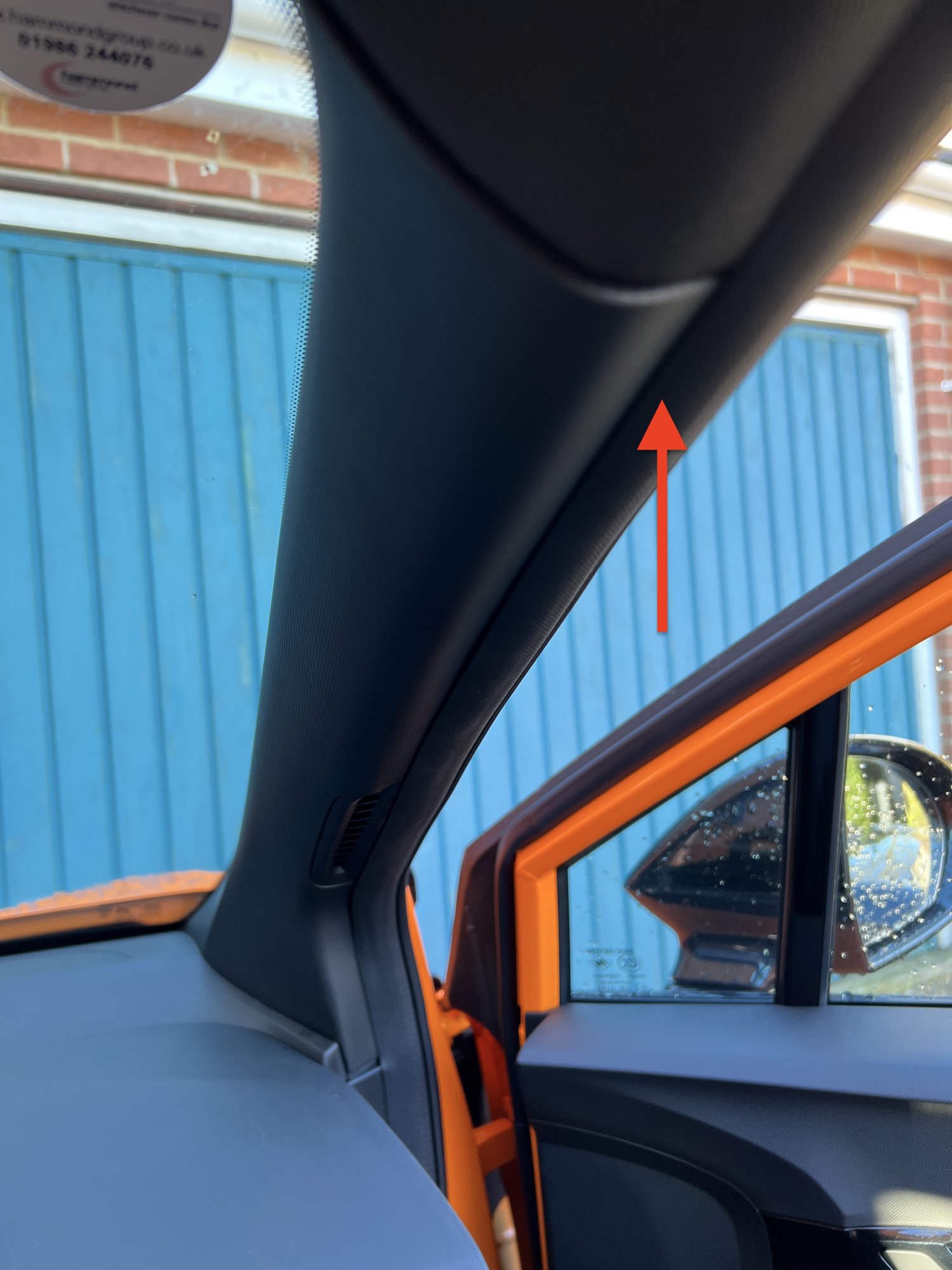

The A pillar is really easy, pull away the rubber trim and you'll easily get in behind the plastic a pillar panel
