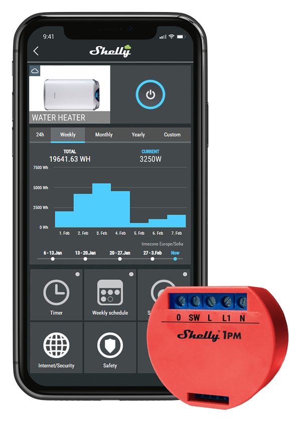

Or even the less well known version of the Shelly One, the 1PM.
Shelly 1PM | Shelly Store UK | Smart Home Automation
Shelly is actually quite well known in the smarthome community. I have a few installed and opted for this instead of the Chinese alternatives because shelly uses certified transformers on their boards. The Chinese do not, implication here is that if you would get in to a malfunction of the device you insurance might not cover the damage if caused by a non certified device. IMHO going cheap for these items is potentially paying the price later in time.
Absolutely, there's lots to recommend Shelly. My point was that the Shelly One is commonly used, but for another £3 the 1PM offers the required extra functionality of power monitoring.
