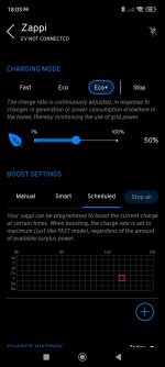

Ensure all schedules are removed from both cars and the Zappi has been used to onboard with the MG as the car. My settings on the Zappi are as attached.
When you plug the MG in select the % to add and the time you require it to finish eg 11.00 am. If you plug the smaller battery in you have to do the sums on the % to add so if the Seat has a 40kW battery it is 80% of the 50kW MG.
My Zappi is simple to use with my SE SR and it's normally set the schedule within about a minute of plugging in.
