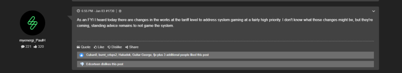

Then there is the question of whether it is really a problem for Octopus in the aggregate
They have confirmed it is on the Zappi integration and are going to make changes to address it. They may be to the detriment of all IOG users (limiting the number of additional hours, billing excessive usage at peak rate etc have been speculated by some)
