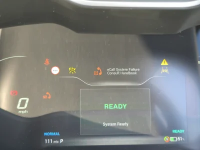

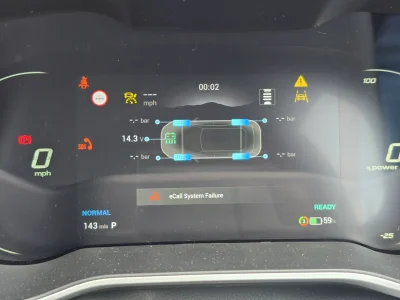

I've taken it for a drive and getting this message:
eCall System Failure Consult Handbook
Ok, that's the cars emergency service calling function not working. This may be a pointer to the problem. Perhaps an antenna issue. I think time to consult your dealer. I take it your 12v battery is well charged?
