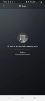

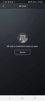

When trying to scan bar code of MG4 vehicle on MG App keep getting This service is not available at the moment please try later .Any ideas?
Hi mate, yes I did.
After scouring around for info there was another thread on here which confirmed my car was still bound to the previous owner hence why it kept reverting back to the bind screen on the app after scanning the QR code or logging in manually.
I contacted MG customer services (as advised by Bam Bam above) by email with my details and the cars reg, VIN, and a screenshot of my V5 and they unbound the car within 24 hours for me. Next time I tried to bind in the car the correct bind to vehicle/connect vehicle button appeared.
