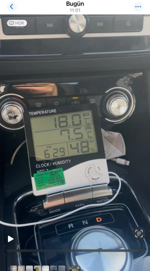

It gets very cold in the section where the pedals are in my 2021 electric MG ZS EV model vehicle. I took it to the authorized service in two different provinces, but they said there was no problem. I measured the lower part with the gadget below, and the seating area. The result is that there is a temperature difference of 10-12 degrees C, I recorded this situation with videos. However, the answer from headquarters is 3. It was in the form of taking it to a technical service. While the temperature inside the vehicle is 18-20 degrees, the foot section is 6-8 degrees. My feet are exposed to the cold like in a refrigerator. I wonder if anyone has a problem similar to this? As seen in the picture, there is a serious temperature difference when the upper part and the foot section are compared.

Even though the ventilation is completely closed, there is a temperature difference between the two sections. I also adjusted the ventilation section from the feet to be directly on the upper section. The result did not change. I also tried the options of inside the vehicle ventilation or outside ventilation, but there was no difference.

When the ventilation is on, the foot section gets hot, there is no problem with that. When I turn the ventilation off, the temperature of the upper section does not change, while the temperature of the foot section drops very quickly. While the temperature in the upper section is 22, the foot section is 14 degrees Celsius
As seen in the photo I added in the message, the upper part is 18 degrees while the foot part is 7.5 degrees. This is the situation when the ventilation is closed.

Even though the air conditioning is on at 27 degrees and the air is in the upper sections except for the feet, when the upper section drops to 26 degrees, the foot section drops to 14 degrees. Unfortunately, it is impossible to drive the vehicle in this way.
