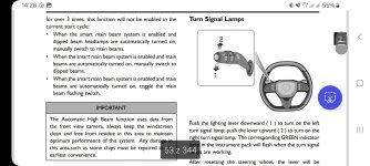

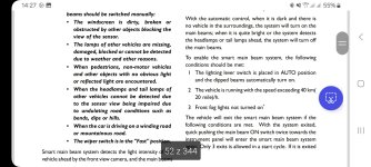

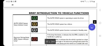

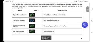

Once again, there is no start-stop system, as this is a hybrid vehicle! Such a system would be redundant because the primary engine driving the car at low speeds is electric.
There are two types of "A" indicators: one represents the auto high-beam lights, while the other refers to the auto-hold system.
The behavior of the auto high beams you described might be due to certain limitations outlined in the manual. I've attached the relevant chapter from the manual, which might help clarify the issue.

The auto headlamp indicator top of screen towards the right. This indicates that the headlamp system is in auto mode. It comes on when the light level falls to the point that main beam is switched on when required. I.e. when there are no vehicles in front of you, or no vehicles coming towards you.
It’s not bad, it not like the magic headlamp controls on my BMW, but it does switch dipped to main beam, and back again, well enough that no one has flashed me.
Thanks again everyone! The green auto headlight symbol still comes and goes but it appears if it's raining AND the speed gets below 25 AND EV mode kicks in, it goes off.
It doesn't affect the lighting operation at all so I'm good with it.
