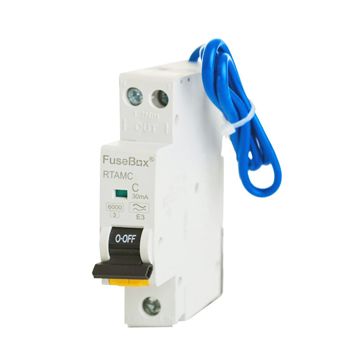

Youre also not supposed to mix different makes withing the CU, theres a 6 amp MCB in there too, it should be changed for a Fusebox make.
