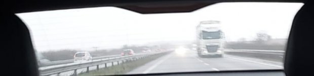

ok - just found something else from this week - hopefelly you get the gist - but the rear screen is fully clear
