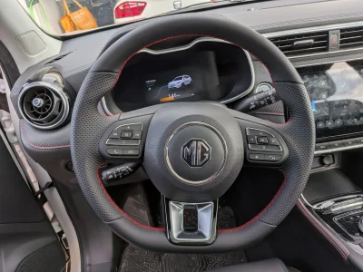

If you look on eBay there are are lots of replacements available for the ZS for less than £100. I once replaced the wheel on my Mk7 Golf with the flappy paddle version and it wasn’t too difficult to do. You need some trim tools, a double square socket set and a torque wrench.
There are leather covers on there too, but they don’t look good to me.
Pic…
