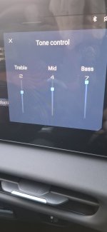

Yes . As mentioned very limited tone control.

Maybe a stupid question, but have you played with the audio settings? My reason for asking - I have an Xpeng G9 Performance with the Dynaudio system (22 speakers) and I was initially disappointed with the audio/bass until I started playing with the settings. Now it sounds great :)
Wow - that looks a lot different than my Xpeng G9 :) . I just ordered my Cyberster, so that's why I asked.
