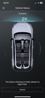

Update!!!
After changing the App Store to Australia/New Zealand on my iPhone (because the car thinks it’s there!) was able to download the app from that region and then did the PP/P CHANGE IN THE menu I was finally able to bind the car YAYY…..BUT the app shows my VIN and the new account info but am unable to actually do anything with the APP find car shows that I’m in Australia which of course I’m not and neither the charging info or anything else works from the app. Tried via WiFi with phone and car on the same WiFi network and no luck either. Wondering if I can change the cars region or if there is another setting.
So some progress but still a way to go

This seems to be the same issue I have with mine. LATAM cars for some reason don't have the tbox enabled. I was able to bind using the European version of the app, while connected to an external Wifi (since the in-car connection does not seem to link with any local provider), but nothing works inside the app. Can't get status, battery charge status, operate hvac, etc. I do have a few dealer options here (Chile) so I'm callign a few of them every other week to inquire about this, since MG itself is advertising iSamrt o ntheir website as being already available here.
