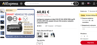

Hello, I have this tested one, it's a bit impractical because it doesn't have a cable, where can we exchange experiences, write a private messageAnd does anyone have a recommendation for an adapter for the MG4 that won't cost 300EUR?
