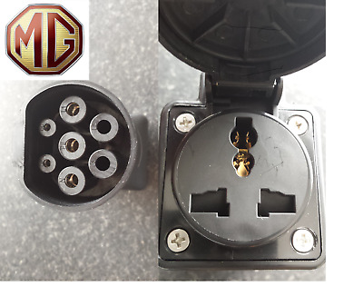

Made my own vehicle to load cable by using the supplied granny chargers type 2 socket and lead and popping a 13a socket on the end.
Swapped the existing resistor for a 470 ohm and gave it a try.
Recognises it as a v2l cable but wont output anything, cycles the locking motor a few times, then gives up, the type 2 works fine as a granny charger so I don't see any reason for it not to lock.

When you say it recognises as a v2l do you get the display asking if you want to discharge?
I made my own from a broken cable and an outdoor socket that now look very similar the the OEM one. Tried it with a toaster and it worked fine.

I was running a 1400 W rotovator from it at the allotment today. Check you haven't set your battery discharge limiter at too high a value. It wasn't working for me last week until I realised I'd set the battery not to discharge if it was below 60%... changed that and it worked fine.

I take it you were sitting in the drivers seat, and selected start discharging?
Thanks for the replies, after I posted I had another look and I had indeed failed to move the slider for the discharge settings as YaR suggested, basic mistake :giggle:
Boiled a kettle and drew 2.3kW so that'll do for camping in comfort.
Nice to have done it for a couple of pounds for a strip of resistors but I'll likely order a dedicated v2l now that they've dropped below £100 for a good one.

The maximum discharge rate is determined by the value of the resistor in the plug.

Not sure about others, but I used Ali express & made my own, its labelled as feyree - very good quality - was around £40 including 3m of cable (HO7B25 EN50620) about 18 months ago
