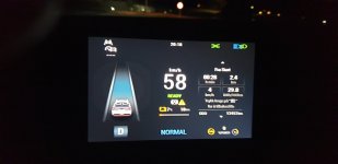

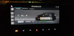

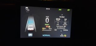

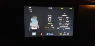

Today I drove my MG4 R46 down to 0% 0km/mls.
Outside temperature -4°C.
Yellow battery gauge and battery symbol came on at 7%.
Yellow Turtle came at 7% and 1-2km less range. Max speed flat road 47 km/h.
Flashing yellow battery symbol at 4% 5km and heater shut off.
3% 3km range, car stopped. Rolled to a stop.
Put the car in park and then drive, drove the last 400m home with max 5-6% with power (note: when starting to drive again I momentarly got at least 17% power output).
0% 1km still flashing yellow battery symbol, the car can still be moved. No battery bar appears.
0% 0km. Still yellow battery symbol, car can be moved, now charging to 100%
