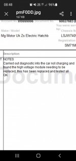

Mine took 3 months to fix hope yours is quicker

This was the poor responce i got.Tbh the dealer did drag their heels but after i kicked off the car was sent to the main mg garage in Birmingham and was repaired whithin a fortnight
