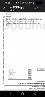

I finally got my car back after 3 months at mg.The dealer couldnt fix it so after many emails by myself to mg customer service the car was sent to longbridge in Birmingham where it was repaired whithin a week.I have been promised a goodwill gesture by the dealer as im around 500 pound down from petrol costs
