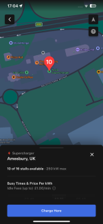

Superchargers and DC, the ones that Tesla made available for public use, photo below
I used those at M5 Gloucester Services (N) on Thursday and that work done as well.
