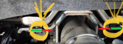

Hi! Answering to your question, before increased the torque on the steering column clamp bolt (first image), before I had made the procedure (second image), after that both procedures until now no clicking. One thing that i have noticed, after increased the torque on the steering column clamp bolt, was that before the steering wheel when manually forced up an down was moving a little bit, after that does not move at all.

After these two procedures, it only remains to tighten the bolt under the scuttle panel, see picture... Some info I read was in this forum, in this old thread An update on the increasing play on my loose steering column :)
Maybe we need the three procedures all together, and perhaps someone with proper tools (torque meter) can give a complete and definitive solution to the problem, and make a video tutorial with torque values to show MG how to solve the problem! ;)

Looming at the pictures, it seems the fixing bolts include a thick rubber washer, probably to reduce vibration on the steering wheel. Tightening these bolts will obviously reduce the damping effect, although that may not matter. This may also explain why the noise returns.
