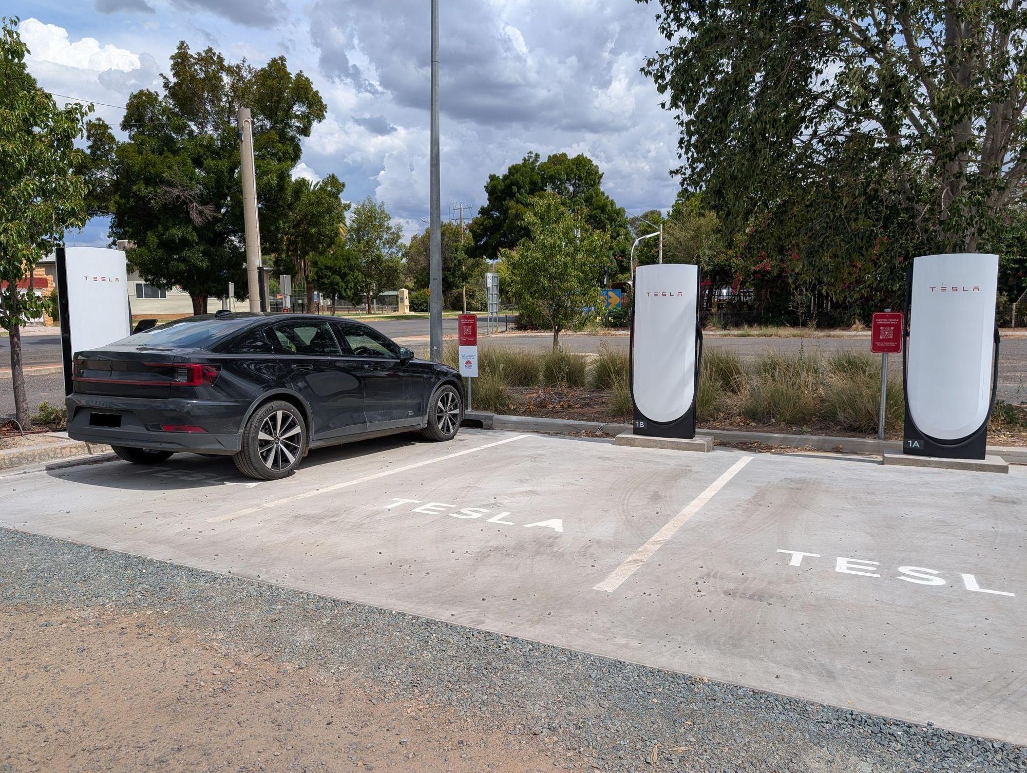

Darn it... First hiccup. The Hay superchargers are running very slowly. Only getting 30kW. I'll be 45 minutes later to Mildura than planned.

What should they deliver? Superchargers by definition I think should be at least 150kW & up to 350kW. I have only used Evie superchargers & they were rated at 350kW & the MG was at its peak of 140kW when I plugged in with about 30% battery left.
If I have the right place, they are V4s, so they should be capable of 250 kW each, no interference with other users.
Plugshare doesn't mention a site limitation.

Yeah, I get 144kW when the SoC is low and by 50%SoC it drops to around 60-70kW.
30kW is really low!
There weren't any other cars plugged in at the time so I couldn't ask what they were getting.
Ah well, such is life.
...and I'm on holiday time, so really, who cares :D
...and the Yass and Wagga Wagga superchargers were working just fine.
Did you try disconnecting, and reconnecting? Just in case it as some sort of communication glitch between car and charger.
Think I'd have tried another charge station.
Yes, sort of...
I was at 50% SoC after 30 minutes when I got back to the car and noticed the very slow charging so finished it and went around to the single bay nrma tritium 50kW charger to see what it was doing. I got almost the same rate (29kW) and went and got a drink.
They stop at 80% so as I needed to get to Mildura figured I'd go back to Tesla charger and try a different one just to add the extra 5% I wanted for the 290kms trip...
The different Tesla unit was still giving me 30kW. I spent the 7 minutes getting my extra 5% and then headed off.
Who knows. Maybe it was my car deciding it was too hot to take any more!
Who knows.
Indeed. At least by trying other options you ruled out the one charge station being an issue.
I just looked at Plugshare logins for that charge stop and there seems to be a common theme of reduced power supply:
Some comments from the feed:
No one here seems to get any higher charge rates than about 100
Finishing charge from yesterday. Only hitting 40kW and I'm at 60%? Was hitting 120-130kW at 50% yesterday. I know it drops but this is not normal haha
It claims to be 250kw but I only seem to you get 96kw
Not always as many charged just fine, nor quite as low as the 30 kW you saw, but definitely others have experienced a lot low lower power than expected given the charger type and their car's state of charge.
So perhaps there were local power supply issues resulting in reduced capacity or perhaps the charge station's cooling system was struggling?
