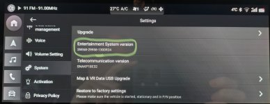

Hi, friends. Please help me. According to the photo I have firmware version R24 in my vehicle? If so, it seems to be a very old version of the firmware, right? I'm reading about R46 versions here. I have the German Luxury version. Is there anyone here who also has this version and newer firmware please? Because I'm still dealing with the problem that the vehicle sometimes won't start heating and the service doesn't know how to fix the fault at all, plus they tell me that I have the latest and newest firmware version loaded in the vehicle. Is he telling the truth? Is the latest version really for MG4 Luxury R24? Thank you very much.

Do you have an SE LR (as your profile says)? In the UK the version numbers for the SE have been:
1100R13
1100R16
1100R21
1100R33 (Latest)
If you have R24 then that suggests you actually have a Trophy (Luxury) and the version is 1300R24. The very latest (currently) is 1300R46 but 1300R40 is more usually installed.
