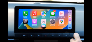

Looks like the next update has fixed car with the side controls being on the right hand side
