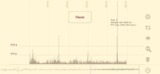

I should add up front that the vibration in mine is not significant and most people probably wouldn't notice it. However, I did a bit of down and dirty analysis just to satisfy my own curiosity. Vibration was measured with an iPhone on steering wheel. I took two samples, one at 70mph and one at 75mph.
There is a small peak at wheel rotation speed which I would expect as no wheel is perfectly balanced but there is a much larger peak at 45Hz (@ 70mph) and then 48Hz (@ 75mph). This is what I feel through the steering wheel. Taking into account errors within my non-calibrated measurement I would take a punt that that the vibration felt is exactly 3 x wheel rotation speed.
Take from that what you will.
