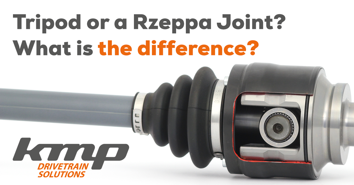

At 3x the rotational frequency, could this be pointing to the (probably inboard) CV joints - specifically "tripod joints" ?
In which case the vibration would be an intrinsic shortcoming of the implementation?

Post 640 refers to a measured frequency of vibration - the fact that it's at 3x the wheel's rotational speed is probably a significant clue. I'm surprised it hasn't already been leaped upon! If the CV joints are the tripod type, then there's the source of the problem (surely!)...
Not that it could be easily cured, I fear...

It's possible but if that's the source it would be a mechanical vibration rather than imbalance. I would expect that to be present regardless of speed. Balance vibrations are generally more pronounced at a certain speed like we experience on the XPower.

Well, both sources of mechanical disturbance would serve to excite a resonance, though I'd agree that out-of-balance would be proportional to the square of the rotational speed, so is more likely to behave as seems to be commonly the case. Does the vibration disappear at higher road speeds?
The vibration on mine starts about 105kph maxes out at 110-115 and is completely gone by 120kph. So very much a resonance issue.
As to whether it's part of the drive chain or part of the steering that's resonating, I've no idea yet.
If we can narrow it down it might be possible to spoil the resonance with a bit of strategically placed extra mass .
