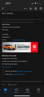

The response!
"Bulldog are you ok to carry out this action please for EVsince2016? You can claim back costs through MG goodwill as per normal process. Prior to the customer leaving your premises, please make sure that relevant software has been installed and tested on Tesla charge points."
Was that from Gary Smart???

Wow. Looks like he has decided to listen to the email I sent him around mine showing him just how wrong he was. Hopefully will get easier moving forward now. A new technical bulletin allowing the updated software to be installed FOC would be a good result.

Now to email Gary Smart, I have its third year service and mot next friday.
Edit: well, well, well.
Good old Mr Smart is based in Dudley, there's only 1 dealer there and it is the one I will be taking my car to next week.
Unsure what he looks like but if its the miserable so and so who i booked it in with, that would explain a lot.

Different places. Mr “Smart” is based in Lowhill Lane HQ, B31 post code.
Not according to his LinkedIn
But I guess it means he won't be there to ask.
