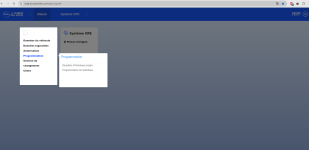

I'm guessing this is where the SNW login is used:
EPC seems to be Electronic Parts Catalog.
Interesting, I wonder what's on that page
The SNW login is what you use for SIPS/VDS to use the software, I hadn't considered a SNW website
Hopefully someone has tried that page & can say if the login works
I had a quick look for the EPC but didn't find anything official, only people trying to sell some software
