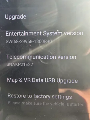

So got it back, they claim to have updated lkas/adas systems and lka and acc did seem a little better on drove home, if anything I'd say a little unresponsive as I was on the white lines and it wasn't alarming. How do I know what they have actually done? I also tried TJA and it was as useless/dangerous as ever. I don't have the new option to disable lka in the drop down menu so does this mean I don't have the r59 update? They also claimed i already have the latest infotainment, but again not convinced by this, pic attached.

Not sure you can check the LKA but my LR is on R63 for info version.
