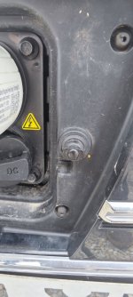

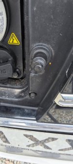

I thought to have a look at my port cover today as I was charging. Here's 2 pictures which explain why you can't just pull the door open. It looks to me as if it's a dealer job unless you get lucky with your pushing.
The first pic is the fully in and locked position, the second is the halfway detent. You can see the locking bar rotatesas the pin goes in and out. When out fully the bar is vertical and I guess it's got stuck or something and the only access is from behind if the door is closed.

Shiv, the emergency release is for a cable stuck in the charging port. But it is not a robust system, for a trapped cable the technique is a gentle pull on the cable and simultaneously a pull on the stuck charging cable. So once you solve the flap problem check that a charging cable will lock, charge and then unlock - just in case your understandable frustration with the flap meant a bit too much force was applied. Experience shows this can be a problem and the fix is a replacement charging port under warranty.
