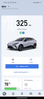

After several weeks of uninstalling/reinstalling plus attempted binding etc, etc the ismart 2 finally came to life today after another reinstalling without any binding required. The set-up clearly has a mind of its own and won't be hurried. Just keep plodding away.

Problem solve after TBOX swap perform in SIPS
And they perform an update for my TBOX just in case
