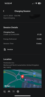

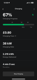

update applied to my LR from early September 2021. Working fine now ?
