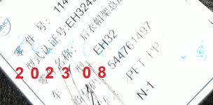

So the parcel shelf wasn't far off then.
I can only make out 2023 08, the rest is completely worn off, I've written the numbers in red below the blue ones.
