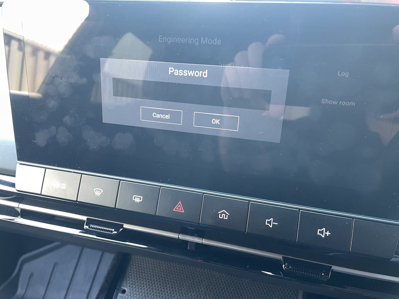

Ok, had a play at lunch time, and got to a familiar screen.
Tap the bottom right corner of the engineering screen 5 times and a password box pops up.
No idea what the code is ..... yet

Well, we aren't all the way in yet but i'm still learning a lot.
Being able to export the Android logs to a USB is quite revealing.
First of all, all the models seem to have the wifi built in (my 51 certainly does), so it should be possible to turn on the hotspot and such. In fact, it looks like all the models have the same basic infotainment unit with the differences being software locked. (except for obvious stuff like missing surround cameras)
This is the system MG has built on:
Mediatek Autus I20 (MT2712)
We've got 4gb of ram and the mine is only using 1gb since it doesn't have the nav app.
The logs are getting spammed with gps data debugging turned on, I wonder if that's part of the reason it's a bit sluggish?
It downloaded 2GB of logs to the USB and that only seems to be for a few days!

It's not 200519 - just tried it. ?
